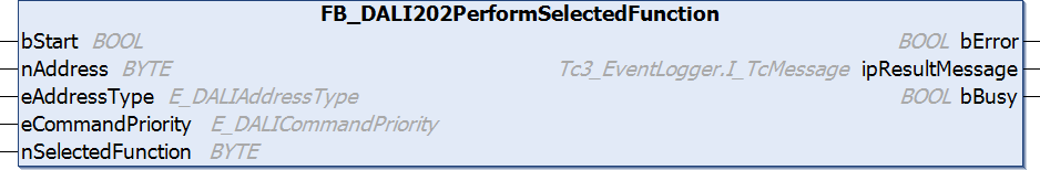

FB_DALI202PerformSelectedFunction
This function block executes certain actions in the DALI control gear depending on the input nSelectedFunction.
The input nSelectedFunction currently defines the following actions:
nSelectedFunction | Description |
0 | All variables are reset to their respective reset values (see variables). |
![]() | Prior to the DALI command PERFORM DTR SELECTED FUNCTION, the function block sends the DALI command ENABLE DEVICE TYPE 1, as is necessary for application extended commands (see also FB_DALI102EnableDeviceType). |
![]() | The function block sends the DALI command PERFORM DTR SELECTED FUNCTION twice, as required by the DALI standard for certain DALI commands. |
![]() | The function block changes the DTR0 of all connected DALI control gears. |
Inputs
bStart : BOOL;
nAddress : BYTE;
nSelectedFunction : BYTE;
Name | Type | Description |
nSelectedFunction | BYTE | Defines the action that the function block should perform (see table above). |
Outputs
bError : BOOL;
bBusy : BOOL;
bBusy | BOOL | The output is set as soon as execution of the DALI commands has commenced. It remains active until all DALI commands have been processed. For some errors (e.g. faulty parameters), bError is set immediately after the positive edge at bStart without bBusy switching to TRUE. |
Properties
ipDALICommunication | I_DALICommunication | Get, Set | NULL | Interface Pointer to the communication block (see Transfer of the reference to the communication block). |
Requirements
TwinCAT from v3.1.4024.35 | Tc3_DALI from v3.13.0.0 |
