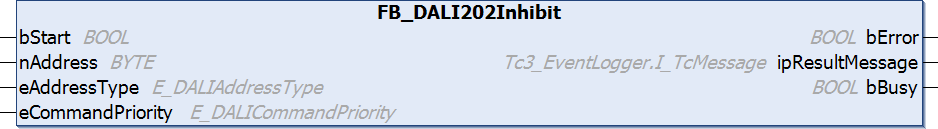

FB_DALI202Inhibit
FB_DALI202Inhibit 1:
This function block prevents the DALI control gear from switching to emergency mode for 15 minutes.
The function block FB_DALI202ReLightResetInhibit can be used to disable inhibition of emergency mode.
FB_DALI202Inhibit 2:
Prior to the DALI command INHIBIT, the function block sends the DALI command ENABLE DEVICE TYPE 1, as is necessary for application extended commands (see also FB_DALI102EnableDeviceType).
FB_DALI202Inhibit 3:
The function block sends the DALI command INHIBIT twice, as required by the DALI standard for certain DALI commands.
FB_DALI202Inhibit 4: Inputs

FB_DALI202Inhibit 5:
FB_DALI202Inhibit 6: Outputs
Type
ipResultMessage
I_TcMessage
bBusy
