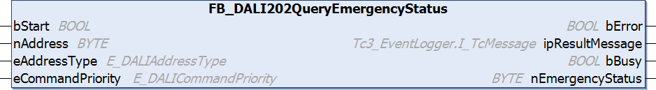

FB_DALI202QueryEmergencyStatus
FB_DALI202QueryEmergencyStatus 1:
The function block reads the variable emergencyStatus from the DALI control gear.
FB_DALI202QueryEmergencyStatus 2:
Prior to the DALI command QUERY EMERGENCY STATUS, the function block sends the DALI command ENABLE DEVICE TYPE 1, as is necessary for application extended commands (see also FB_DALI102EnableDeviceType).
The output nEmergencyStatus contains a valid value only if the function block was executed without errors (bError = FALSE).
FB_DALI202QueryEmergencyStatus 3: Inputs
  bStart            : BOOL;
  nAddress          : BYTE;
Type
bStart
nAddress
BYTE
eAddressType
E_DALIAddressType
eCommandPriority
E_DALICommandPriority
FB_DALI202QueryEmergencyStatus 4:
FB_DALI202QueryEmergencyStatus 5: Outputs
  nEmergencyStatus        : BYTE;
Type
ipResultMessage
I_TcMessage
bBusy
nEmergencyStatus
BYTE
Current information on emergency mode (see emergencyStatus).
FB_DALI202QueryEmergencyStatus 6: Properties
Type
Access
Initial value
ipDALICommunication
I_DALICommunication
Get, Set
NULL
