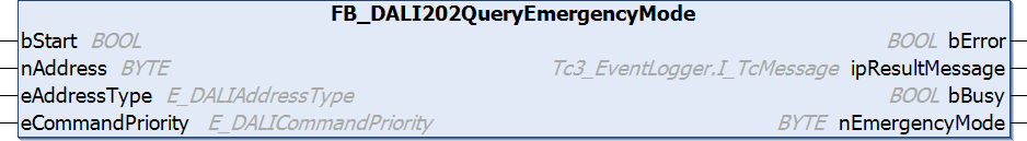

FB_DALI202QueryEmergencyMode
FB_DALI202QueryEmergencyMode 1:
The function block reads the variable emergencyMode from the DALI control gear.
FB_DALI202QueryEmergencyMode 2:
Prior to the DALI command QUERY EMERCENCY MODE, the function block sends the DALI command ENABLE DEVICE TYPE 1, as is necessary for application extended commands (see also FB_DALI102EnableDeviceType).
The output nEmergencyMode contains a valid value only if the function block was executed without errors (bError = FALSE).
FB_DALI202QueryEmergencyMode 3: Inputs
  bStart            : BOOL;
  nAddress          : BYTE;
Type
bStart
nAddress
BYTE
eAddressType
E_DALIAddressType
eCommandPriority
E_DALICommandPriority
FB_DALI202QueryEmergencyMode 4:
FB_DALI202QueryEmergencyMode 5: Outputs
  nEmergencyMode          : BYTE;
Type
ipResultMessage
I_TcMessage
bBusy
nEmergencyMode
BYTE
Information about the current operating mode of the DALI control gear (see emergencyMode).
