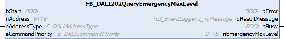

FB_DALI202QueryEmergencyMaxLevel
FB_DALI202QueryEmergencyMaxLevel 1:
The function block reads the variable emergencyMaxLevel from the DALI control gear.
bError is set to TRUE if the DALI control gear returns the value 255 (MASK). In this case, the value cannot be determined by the DALI control gear.
FB_DALI202QueryEmergencyMaxLevel 2:
Prior to the DALI command QUERY EMERGENCY MAX LEVEL, the function block sends the DALI command ENABLE DEVICE TYPE 1, as is necessary for application extended commands (see also FB_DALI102EnableDeviceType).
The output nEmergencyMaxLevel contains a valid value only if the function block was executed without errors (bError = FALSE).

FB_DALI202QueryEmergencyMaxLevel 4:
FB_DALI202QueryEmergencyMaxLevel 5: Outputs
  nEmergencyMaxLevel      : BYTE;
Type
ipResultMessage
I_TcMessage
bBusy
nEmergencyMaxLevel
BYTE
Maximum output value from DALI control gear in emergency mode (see emergencyMaxLevel).
