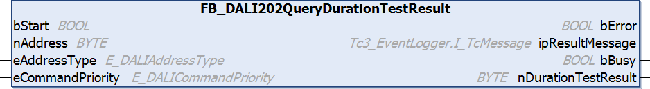

The function block reads the variable durationTestResult from the DALI control gear.
FB_DALI202QueryDurationTestResult 2:
Prior to the DALI command QUERY DURATION TEST RESULT, the function block sends the DALI command ENABLE DEVICE TYPE 1, as is necessary for application extended commands (see also FB_DALI102EnableDeviceType).
The output nDurationTestResult only contains a valid value if the function block was executed without errors (bError = FALSE).
FB_DALI202QueryDurationTestResult 3: Inputs
  bStart            : BOOL;
  nAddress          : BYTE;
Type
bStart
nAddress
BYTE
eAddressType
E_DALIAddressType
eCommandPriority
E_DALICommandPriority
FB_DALI202QueryDurationTestResult 4:
FB_DALI202QueryDurationTestResult 5: Outputs
  nDurationTestResult     : BYTE;
Type
ipResultMessage
I_TcMessage
bBusy
nDurationTestResult
BYTE
Result of the duration test in steps of 2 minutes (see durationTestResult).
