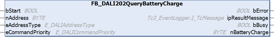

FB_DALI202QueryBatteryCharge
The function block reads the variable batteryCharge from the DALI control gear.
bError is set to TRUE if the DALI control gear returns the value 255 (MASK). In this case, the value cannot be determined by the DALI control gear.
![]() | Prior to the DALI command QUERY BATTERY CHARGE, the function block sends the DALI command ENABLE DEVICE TYPE 1, as is necessary for application extended commands (see also FB_DALI102EnableDeviceType). |
The output nBatteryCharge only contains a valid value if the function block was executed without errors (bError = FALSE).

bBusy | BOOL | The output is set as soon as execution of the DALI commands has commenced. It remains active until all DALI commands have been processed. For some errors (e.g. faulty parameters), bError is set immediately after the positive edge at bStart without bBusy switching to TRUE. |
nBatteryCharge
| BYTE | Battery charge status 0: empty / 254: full (see batteryCharge). |
