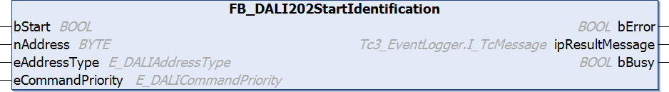

FB_DALI202StartIdentification
The function block starts or extends the identification routine of the DALI control gear.
The routine takes approx. 10 s and ends automatically. The exact scope of the identification routine depends on the manufacturer of the DALI control gear.
![]() | Prior to the DALI command START IDENTIFICATION, the function block sends the DALI command ENABLE DEVICE TYPE 1, as is necessary for application extended commands (see also FB_DALI102EnableDeviceType). |
![]() | The function block sends the DALI command START IDENTIFICATION twice, as required by the DALI standard for certain DALI commands. |
Inputs
bStart : BOOL;
nAddress : BYTE;
Outputs
bError : BOOL;
bBusy : BOOL;
bBusy | BOOL | The output is set as soon as execution of the DALI commands has commenced. It remains active until all DALI commands have been processed. For some errors (e.g. faulty parameters), bError is set immediately after the positive edge at bStart without bBusy switching to TRUE. |
