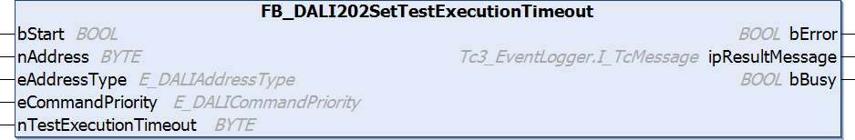

The function block stores the value nTestExecutionTimeout in the variable testExecutionTimeout of the DALI control gear.
FB_DALI202SetTestExecutionTimeout 2:
Prior to the DALI command SET TEST EXECUTION TIMEOUT, the function block sends the DALI command ENABLE DEVICE TYPE 1, as is necessary for application extended commands (see also FB_DALI102EnableDeviceType).
FB_DALI202SetTestExecutionTimeout 3:
The function block sends the DALI command SET TEST EXECUTION TIMEOUT twice, as required by the DALI standard for certain DALI commands.
FB_DALI202SetTestExecutionTimeout 4:
The function block changes the DTR0 of all connected DALI control gears.
FB_DALI202SetTestExecutionTimeout 5: Inputs
  bStart                : BOOL;
  nAddress              : BYTE;
  eAddressType          : E_DALIAddressType := E_DALIAddressType.Short;
  eCommandPriority      : E_DALICommandPriority := E_DALICommandPriority.MiddleLow;
  eDimmingCurve         : E_DALIDimmingCurve := E_DALIDimmingCurve.Standard;
  nTestExecutionTimeout : BYTE := 7;
Type
bStart
nAddress
BYTE
eAddressType
E_DALIAddressType
eCommandPriority
FB_DALI202SetTestExecutionTimeout 6:
Type
BYTE
Maximum execution time for the tests (see testExecutionTimeout).
FB_DALI202SetTestExecutionTimeout 7: Outputs
Type
ipResultMessage
I_TcMessage
bBusy
FB_DALI202SetTestExecutionTimeout 8: Properties
Type
Access
Initial value
ipDALICommunication
I_DALICommunication
Get, Set
NULL
Requirements
Development environment
Required PLC library
TwinCAT from v3.1.4024.35
Tc3_DALI from v3.13.0.0
