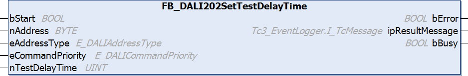

FB_DALI202SetTestDelayTime
FB_DALI202SetTestDelayTime 1:
The function block stores the value nDelayTestTime in the variable testDelayTime of the DALI control gear.
FB_DALI202SetTestDelayTime 2:
Prior to the DALI commands SET TEST DELAY TIME LSB and SET TEST DELAY TIME MSB, the function block sends the DALI command ENABLE DEVICE TYPE 1, as is necessary for application extended commands (see also FB_DALI102EnableDeviceType).
FB_DALI202SetTestDelayTime 3:
The function block sends the DALI commands SET TEST DELAY TIME LSB and SET TEST DELAY TIME MSB twice, as required by the DALI standard for certain DALI commands.
FB_DALI202SetTestDelayTime 4:
The function block changes the DTR0 of all connected DALI control gears.
FB_DALI202SetTestDelayTime 5: Inputs
  bStart                : BOOL;
  nAddress              : BYTE;
  eAddressType          : E_DALIAddressType := E_DALIAddressType.Short;
  eCommandPriority      : E_DALICommandPriority := E_DALICommandPriority.MiddleLow;
  eDimmingCurve         : E_DALIDimmingCurve := E_DALIDimmingCurve.Standard;
  nTestDelayTime        : UINT := 0;
