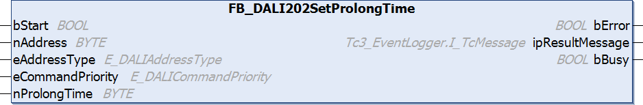

FB_DALI202SetProlongTime 1:
The function block stores the value nProlongTime in the variable prolongTime of the DALI control gear.
FB_DALI202SetProlongTime 2:
Prior to the DALI command SET PROLONG TIME, the function block sends the DALI command ENABLE DEVICE TYPE 1, as is necessary for application extended commands (see also FB_DALI102EnableDeviceType).
FB_DALI202SetProlongTime 3:
The function block sends the DALI command SET PROLONG TIME twice, as required by the DALI standard for certain DALI commands.
FB_DALI202SetProlongTime 4:
The function block changes the DTR0 of all connected DALI control gears.
FB_DALI202SetProlongTime 5: Inputs
  bStart                : BOOL;
  nAddress              : BYTE;
  eAddressType          : E_DALIAddressType := E_DALIAddressType.Short;
  eCommandPriority      : E_DALICommandPriority := E_DALICommandPriority.MiddleLow;
  eDimmingCurve         : E_DALIDimmingCurve := E_DALIDimmingCurve.Standard;
  nProlongTime          : BYTE := 0;
Type
bStart
nAddress
BYTE
eAddressType
E_DALIAddressType
eCommandPriority
FB_DALI202SetProlongTime 6:
Type
nProlongTime
BYTE
Time period for prolongation of emergency mode after return of mains voltage (see prolongTime).
FB_DALI202SetProlongTime 7: Outputs
Type
ipResultMessage
I_TcMessage
bBusy
FB_DALI202SetProlongTime 8: Properties
Type
Access
Initial value
ipDALICommunication
I_DALICommunication
Get, Set
NULL
