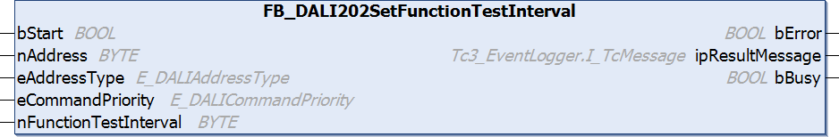

FB_DALI202SetFunctionTestInterval
The function block stores the value nFunctionTestInterval in the variable functionTestInterval of the DALI control gear.
![]() | Prior to the DALI command SET FUNCTION TEST INTERVAL, the function block sends the DALI command ENABLE DEVICE TYPE 1, as is necessary for application extended commands (see also FB_DALI102EnableDeviceType). |
![]() | The function block sends the DALI command SET FUNCTION TEST INTERVAL twice, as required by the DALI standard for certain DALI commands. |
![]() | The function block changes the DTR0 of all connected DALI control gears. |
Inputs
bStart : BOOL;
nAddress : BYTE;
eDimmingCurve : E_DALIDimmingCurve := E_DALIDimmingCurve.Standard;
nfunctionTestInterval : BYTE := 7;
Name | Type | Description |
nFunctionTestInterval | BYTE | Interval time for the function test (see functionTestInterval). |
Outputs
bError : BOOL;
bBusy : BOOL;
bBusy | BOOL | The output is set as soon as execution of the DALI commands has commenced. It remains active until all DALI commands have been processed. For some errors (e.g. faulty parameters), bError is set immediately after the positive edge at bStart without bBusy switching to TRUE. |
Properties
ipDALICommunication | I_DALICommunication | Get, Set | NULL | Interface Pointer to the communication block (see Transfer of the reference to the communication block). |
Requirements
TwinCAT from v3.1.4024.35 | Tc3_DALI from v3.13.0.0 |
