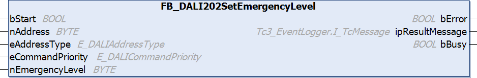

FB_DALI202SetEmergencyLevel 5: Inputs
  bStart                : BOOL;
  nAddress              : BYTE;
  eAddressType          : E_DALIAddressType := E_DALIAddressType.Short;
  eCommandPriority      : E_DALICommandPriority := E_DALICommandPriority.MiddleLow;
  eDimmingCurve         : E_DALIDimmingCurve := E_DALIDimmingCurve.Standard;
  nEmergencyLevel       : BYTE := 254;
Type
bStart
nAddress
BYTE
eAddressType
E_DALIAddressType
eCommandPriority
FB_DALI202SetEmergencyLevel 6:
Type
nEmergencyLevel
BYTE
Output value from DALI control gear in emergency mode (see emergencyLevel).
