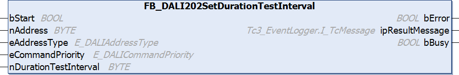

FB_DALI202SetDurationTestInterval
The function block stores the value nDurationTestInterval in the variable durationTestInterval of the DALI control gear.
![]() | Prior to the DALI command SET DURATION TEST INTERVAL, the function block sends the DALI command ENABLE DEVICE TYPE 1, as is necessary for application extended commands (see also FB_DALI102EnableDeviceType). |
![]() | The function block sends the DALI command SET DURATION TEST INTERVAL twice, as required by the DALI standard for certain DALI commands. |
![]() | The function block changes the DTR0 of all connected DALI control gears. |
Inputs
bStart : BOOL;
nAddress : BYTE;
eDimmingCurve : E_DALIDimmingCurve := E_DALIDimmingCurve.Standard;
nDurationTestInterval : BYTE := 52;
Name | Type | Description |
nDurationTestInterval | BYTE | Interval time for the duration test (see durationTestInterval) |
Outputs
bError : BOOL;
bBusy : BOOL;
bBusy | BOOL | The output is set as soon as execution of the DALI commands has commenced. It remains active until all DALI commands have been processed. |
Properties
ipDALICommunication | I_DALICommunication | Get,Set | 0 | Interface Pointer to the communication block (see Transfer of the reference to the communication block). |
Requirements
TwinCAT from v3.1.4024.35 | Tc3_DALI from v3.13.0.0 |
