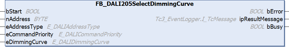

FB_DALI205SelectDimmingCurve
The function block stores the value eDimmingCurve in the variable dimmingCurve of the DALI control gear. This also changes the value of the Delay Time.
![]() | Prior to the DALI command SELECT DIMMING CURVE, the function block sends the DALI command ENABLE DEVICE TYPE 4, as is necessary for application extended commands (see also FB_DALI102EnableDeviceType). |
![]() | The function block sends the DALI command SELECT DIMMING CURVE twice, as required by the DALI standard for certain DALI commands. |
![]() | The function block changes the DTR0 of all connected DALI control gears. |
Inputs
Var_INPUT
bStart : BOOL;
nAddress : BYTE;
eDimmingCurve : E_DALIDimmingCurve := E_DALIDimmingCurve.Standard;
Name | Type | Description |
eDimmingCurve
| E_DALIDimmingCurve | Linear or standard dimming curve (see E_DALIDimmingCurve) |
Outputs
bError : BOOL;
bBusy : BOOL;
bBusy | BOOL | The output is set as soon as execution of the DALI commands has commenced. It remains active until all DALI commands have been processed. |
