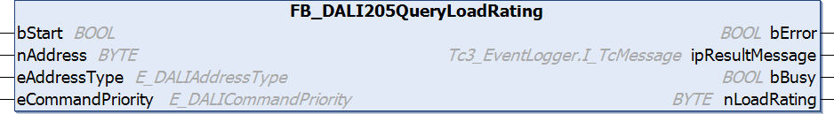

The function block reads the maximum permissible root mean square of the load current from the DALI control gear (see loadRating).
bError is set to TRUE if the DALI control gear returns the value 255 (MASK). In this case, the value cannot be determined by the DALI control gear.
FB_DALI205QueryLoadRating 2:
Prior to the DALI command QUERY LOAD RATING, the function block sends the DALI command ENABLE DEVICE TYPE 4, as is necessary for application extended commands (see also FB_DALI102EnableDeviceType).
The output nLoadRating contains a valid value only if the function block was executed without errors (bError = FALSE).
FB_DALI205QueryLoadRating 3: Inputs
  bStart            : BOOL;
  nAddress          : BYTE;
Type
bStart
nAddress
BYTE
eAddressType
E_DALIAddressType
eCommandPriority
E_DALICommandPriority
FB_DALI205QueryLoadRating 4:
FB_DALI205QueryLoadRating 5: Outputs
  nLoadRating             : BYTE;
Type
ipResultMessage
I_TcMessage
bBusy
nLoadRating
BYTE
Returns the maximum permissible root mean square of the load current (see loadRating).
