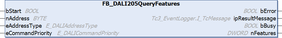

The function block reads the implemented properties from the DALI control gear (see dimmerFeatures).
FB_DALI205QueryFeatures 2:
Prior to the DALI command QUERY FEATURES, the function block sends the DALI command ENABLE DEVICE TYPE 4, as is necessary for application extended commands (see also FB_DALI102EnableDeviceType).
The output nFeatures contains a valid value only if the function block was executed without errors (bError = FALSE).
FB_DALI205QueryFeatures 3: Inputs
  bStart            : BOOL;
  nAddress          : BYTE;
Type
bStart
nAddress
BYTE
eAddressType
E_DALIAddressType
eCommandPriority
E_DALICommandPriority
FB_DALI205QueryFeatures 4:
FB_DALI205QueryFeatures 5: Outputs
  nFeatures               : DWORD;
Type
ipResultMessage
I_TcMessage
bBusy
nFeatures
DWORD
Returns information about the implemented features (see dimmerFeatures).
