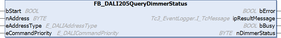

FB_DALI205QueryDimmerStatus
FB_DALI205QueryDimmerStatus 1:
The function block reads the current operation mode from the DALI control gear (see dimmerStatus).
FB_DALI205QueryDimmerStatus 2:
Prior to the DALI command QUERY DIMMER STATUS, the function block sends the DALI command ENABLE DEVICE TYPE 4, as is necessary for application extended commands (see also FB_DALI102EnableDeviceType).
The output nDimmerStatus only contains a valid value if the function block was executed without errors (bError = FALSE).
FB_DALI205QueryDimmerStatus 3: Inputs
  bStart            : BOOL;
  nAddress          : BYTE;
Type
bStart
nAddress
BYTE
eAddressType
E_DALIAddressType
eCommandPriority
E_DALICommandPriority
FB_DALI205QueryDimmerStatus 4:
FB_DALI205QueryDimmerStatus 5: Outputs
  nDimmerStatus           : BYTE;
Type
ipResultMessage
I_TcMessage
bBusy
nDimmerStatus
BYTE
Returns the current operation mode (see dimmerStatus).
FB_DALI205QueryDimmerStatus 6: Properties
Type
Access
Initial value
ipDALICommunication
I_DALICommunication
Get, Set
NULL
Requirements
Development environment
Required PLC library
TwinCAT from v3.1.4024.35
Tc3_DALI from v3.13.0.0
