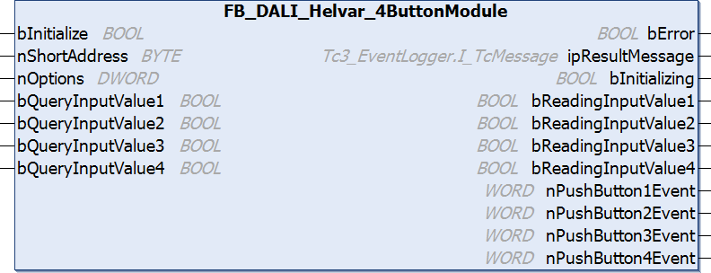

FB_DALI_Helvar_4ButtonModule 4: Inputs
  bInitialize          : BOOL  := FALSE;
  nShortAddress        : BYTE  := 0;
  nOptions             : DWORD := 0;
  bQueryInputValue1    : BOOL := FALSE;
  bQueryInputValue2    : BOOL := FALSE;
  bQueryInputValue3    : BOOL := FALSE;
  bQueryInputValue4    : BOOL := FALSE;
Type
bInitialize
The configuration of the DALI control device is started by a positive edge at this input. During this time no DALI commands are processed.
nShortAddress
BYTE
Short address of the DALI control device.
nOptions
DWORD
Reserved for future extensions.
bQueryInputValueN
The state of the corresponding push button is queried immediately by a positive edge at this input.
FB_DALI_Helvar_4ButtonModule 5: Outputs
  bError                 : BOOL;
  ipResultMessage        : I_TcMessage;
  bInitializing          : BOOL;
  bReadingInputValue1    : BOOL;
  bReadingInputValue2    : BOOL;
  bReadingInputValue3    : BOOL;
  bReadingInputValue4    : BOOL;
  nPushButton1Event      : WORD;
  nPushButton2Event      : WORD;
  nPushButton3Event      : WORD;
  nPushButton4Event      : WORD;
Type
This output is switched to TRUE if an error occurs during the execution. Further information about the error can be queried via the variable ipResultMessage.
ipResultMessage
I_TcMessage
Interface pointer (see error evaluation) that can be used to obtain detailed information about the processing of the function block (see runtime messages).
bInitializing
The output is set as soon as the initialization of the DALI control device has been started, and remains active until all DALI commands have been executed.
bReadingInputValueN
The outputs are set as soon as the manual reading of the corresponding input has been triggered.
nPushButtonNEvent
The outputs output the events for the corresponding push button via one bit for one cycle.
Bit
0
Push button released.
1
Push button pressed.
2
Short keystroke.
3
Double keystroke.
4
Start long keystroke.
5
Repeat long keystroke.
6
Stop long keystroke.
7
Push button free again; was previously blocked.
8
Push button blocked.
The function block FB_DALI_ToPushButtonState can be used to convert the state of a push button into a BOOL variable.
