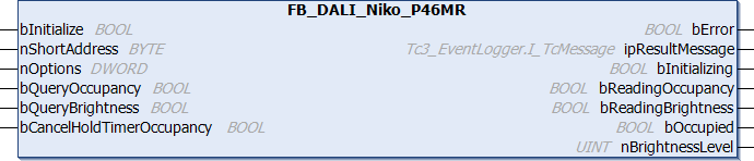

The function block represents the DALI sensors P46MR for surface mounting, P46MR for SnapFit flush mounting and P46MR for flush-mounting box from Niko.
This outputs an occupancy signal (instance 0) and a brightness value (instance 1).
The light sensor supports two different value ranges. This can be set to 0...1023 lx (10 bits) or 0...10360 lx (14 bits) via the nLuxRangeBrightness property. The smaller value range (10 bits) has the advantage that the DALI bus is slightly less loaded than with the larger value range (14 bits).
For information on the exact functions of the individual instances, please refer to the manufacturer's device documentation.
Further information on the supported instance types can be found here:
Part 303 (occupancy sensors) – Introduction
Part 304 (light sensors) – Introduction
The existing parameters can be overwritten by changing the properties listed below. All parameters are written to the DALI control device by a positive edge at bInitialize and stored there.
The outputs with the output values of the DALI device only contain valid values if the function block was executed without errors (bError = FALSE). If the output bError = TRUE, the outputs with the output values must not be evaluated.
The reading can be triggered immediately via the input variables bQueryOccupancy and bQueryBrightness, even if the corresponding instance is not enabled.

FB_DALI_Niko_P46MR 4: Inputs
  bInitialize                 : BOOL  := FALSE;
  nShortAddress               : BYTE  := 0;
  nOptions                    : DWORD := 0;
  bQueryOccupancy             : BOOL  := FALSE;
  bQueryBrightness            : BOOL  := FALSE;
  bCancelHoldTimerOccupancy   : BOOL  := FALSE;

FB_DALI_Niko_P46MR 5: Outputs
  bError                     : BOOL;
  ipResultMessage            : I_TcMessage;
  bInitializing              : BOOL;
  bReadingOccupancy          : BOOL;
  bReadingBrightness         : BOOL;
  bOccupied                  : BOOL;
  nBrightnessLevel           : UINT;
