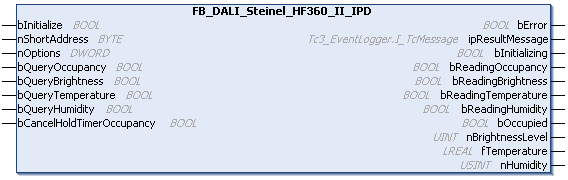

FB_DALI_Steinel_HF360_II_IPD 1:
The function block represents the HF 360 II IPD DALI sensor from Steinel.
This outputs the measured brightness value (instance 0), an occupancy signal (instance 1), a temperature value (instance 2) and a value for the relative humidity (instance 3).
Further information on the supported instance types can be found here:
Part 303 (occupancy sensors) - Introduction
Part 304 (light sensors) - Introduction
The existing parameters can be overwritten by changing the properties listed below. All parameters are written to the DALI control device by a positive edge at bInitialize and stored there.
The outputs with the output values of the DALI device only contain valid values if the function block was executed without errors (bError = FALSE). If the output bError = TRUE, the outputs with the output values must not be evaluated.
The temperature measurement and humidity measurement are executed as Generic Inputs. These values can only be queried via a positive edge at the inputs bQueryTemperature and bQueryHumidity.
For the other instances, the reading can also be triggered directly via the inputs bQueryBrightness and bQueryOccupancy, even if the corresponding instance is not enabled.

FB_DALI_Steinel_HF360_II_IPD 4: Inputs
  bInitialize                 : BOOL  := FALSE;
  nShortAddress               : BYTE  := 0;
  nOptions                    : DWORD := 0;
  bQueryOccupancy             : BOOL  := FALSE;
  bQueryBrightness            : BOOL  := FALSE;
  bQueryTemperature           : BOOL  := FALSE;
  bQueryHumidity              : BOOL  := FALSE;
  bCancelHoldTimerOccupancy   : BOOL  := FALSE;

FB_DALI_Steinel_HF360_II_IPD 5: Outputs
  bError                     : BOOL;
  ipResultMessage            : I_TcMessage;
  bInitializing              : BOOL;
  bReadingOccupancy          : BOOL;
  bReadingBrightness         : BOOL;
  bReadingTemperature        : BOOL;
  bReadingHumidity           : BOOL;
  bOccupied                  : BOOL;
  nBrightnessLevel           : UINT;
  fTemperature               : LREAL;
  nHumidity                  : USINT;
