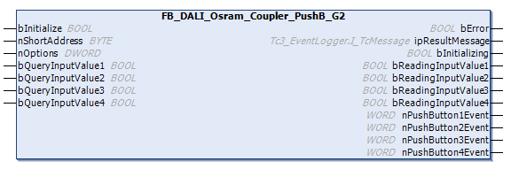

The function block represents the DALI COUPLER PushB G2 DALI push button interface from Osram.
Up to four push buttons (instances 0 to 3) can be connected directly via the device.
For information on the exact functions of the individual instances, please refer to the manufacturer's device documentation.
Further information on the supported instance types can be found here:
Part 301 (push buttons) - Introduction
The existing parameters can be overwritten by changing the properties listed below. All parameters are written to the DALI control device by a positive edge at bInitialize and stored there.
The outputs with the output values of the DALI device only contain valid values if the function block was executed without errors (bError = FALSE). If the output bError = TRUE, the outputs with the output values must not be evaluated.
The reading of the corresponding instance can be triggered immediately via the input variable bQueryInputValueN, even if the corresponding instance is not enabled.
The properties bEnablePushButtonN make it possible to disable individual instances.

FB_DALI_Osram_Coupler_PushB_G2 4: Inputs
  bInitialize               : BOOL  := FALSE;
  nShortAddress             : BYTE  := 0;
  nOptions                  : DWORD := 0;
  bQueryInputValue1         : BOOL  := FALSE;
  bQueryInputValue2         : BOOL  := FALSE;
  bQueryInputValue3         : BOOL  := FALSE;
  bQueryInputValue4         : BOOL  := FALSE;

FB_DALI_Osram_Coupler_PushB_G2 5: Outputs
  bInitializing           : BOOL;
  bReadingInputValue1     : BOOL;
  bReadingInputValue2     : BOOL;
  bReadingInputValue3     : BOOL;
  bReadingInputValue4     : BOOL;
  nPushButton1Event       : WORD;
  nPushButton2Event       : WORD;
  nPushButton3Event       : WORD;
  nPushButton4Event       : WORD;
