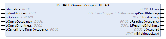

FB_DALI_Osram_Coupler_HF_G2
FB_DALI_Osram_Coupler_HF_G2 1:
The function block represents the DALI COUPLER HF G2 DALI sensor from Osram.
This outputs the measured brightness value (instance 1) and an occupancy signal (instance 0).
Further information on the supported instance types can be found here:
Part 303 (occupancy sensors) – Introduction
Part 304 (light sensors) - Introduction
The existing parameters can be overwritten by changing the properties listed below. All parameters are written to the DALI control device by a positive edge at bInitialize and stored there.
The outputs with the output values of the DALI device only contain valid values if the function block was executed without errors (bError = FALSE). If the output bError = TRUE, the outputs with the output values must not be evaluated.
The reading can be triggered immediately via the input variables bQueryOccupancy and bQueryBrightness, even if the corresponding instance is not enabled.

FB_DALI_Osram_Coupler_HF_G2 4: Inputs
  bInitialize                 : BOOL  := FALSE;
  nShortAddress               : BYTE  := 0;
  nOptions                    : DWORD := 0;
  bQueryOccupancy             : BOOL  := FALSE;
  bQueryBrightness            : BOOL  := FALSE;
  bCancelHoldTimerOccupancy   : BOOL  := FALSE;

FB_DALI_Osram_Coupler_HF_G2 5: Outputs
  bError                     : BOOL;
  ipResultMessage            : I_TcMessage;
  bInitializing              : BOOL;
  bReadingOccupancy          : BOOL;
  bReadingBrightness         : BOOL;
  bOccupied                  : BOOL;
  nBrightnessLevel           : UINT;
