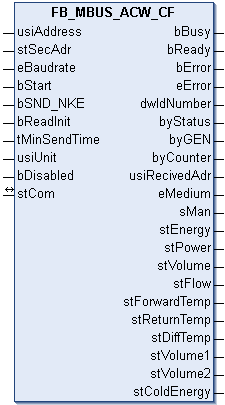

FB_MBUS_ACW_CF
FB_MBUS_ACW_CF 1:
The function block FB_MBUS_ACW_CF is used to read heat meters from Actaris:
-CF-Echo II
-CF-51
-CF-55
Up to two additional water meters can be connected to this device (optional).
The function block can only be executed together with the function block FB_MBUSKL6781().
FB_MBUS_ACW_CF 2:
Further information
See Operating principle of the function block
