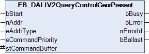

FB_DALIV2QueryControlGearPresent 3: Inputs/outputs
  stCommandBuffer : ST_DALIV2CommandBuffer;
Type
stCommandBuffer
Reference to the internal structure for communication with FB_KL6811Communication (KL6811) or FB_KL6821Communication (KL6821).
FB_DALIV2QueryControlGearPresent 4: Outputs
  bBusy     : BOOL;
  bError    : BOOL;
  nErrorId  : UDINT;
  bBallast  : BOOL
Type
bBusy
This output is switched to TRUE as soon as an error occurs during the execution of a command. The command-specific error code is contained in nErrorId. Is reset to FALSE by the execution of a command at the inputs.
nErrorId
UDINT
Contains the command-specific error code of the most recently executed command. Is reset to 0 by the execution of a command at the inputs (see error codes).
bBallast
If the output is active, the corresponding control gear is ready to operate.
