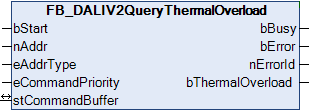

FB_DALIV2QueryThermalOverload
The function block FB_DALIV2QueryThermalOverload queries whether there is a thermal overload with a reduction in luminous flux.
![]()  | This command is one of the application extended commands for LED modules with DALI interface. These only work if they are preceded by the Enable Device Type 6 command, which can be sent with the function block FB_DALIV2EnableDeviceType. The command Enable Device Type 6 is automatically internally prefixed to all application extended commands for DALI LED modules.  |
 Inputs
  bStart           : BOOL;
  nAddr            : BYTE;
  eAddrType        : E_DALIV2AddrType := eDALIV2AddrTypeShort;
  eCommandPriority : E_DALIV2CommandPriority := eDALIV2CommandPriorityMiddle;
END_VARName  | Type  | Description  |
bStart  | BOOL  | The function block is activated by a positive edge at this input.  |
nAddr  | BYTE  | The address of a device or of a group  |
eAddrType  | Short address, group address or broadcast  | |
eCommandPriority  | Priority (high, medium or low) with which the command is processed by the library.  |
 Inputs/outputs
  stCommandBuffer : ST_DALIV2CommandBuffer;
stCommandBuffer  | ST_DALIV2CommandBuffer  | Reference to the internal structure for communication with FB_KL6811Communication (KL6811) or FB_KL6821Communication (KL6821).  |
 Outputs
  bBusy                        : BOOL;
  bError                       : BOOL;
  nErrorId                     : UDINT;
  bThermalOverload             : BOOL;
bBusy  | BOOL  | When the function block is activated the output is set, and it remains active until execution of the command has been completed.  |
bError  | BOOL  | This output is switched to TRUE as soon as an error occurs during the execution of a command. The command-specific error code is contained in nErrorId. Is reset to FALSE by the execution of a command at the inputs.  |
nErrorId  | UDINT  | Contains the command-specific error code of the most recently executed command. Is reset to 0 by the execution of a command at the inputs (see error codes).  |
bThermalOverload  | BOOL  | Thermal overload  |
