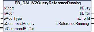

FB_DALIV2QueryReferenceRunning
FB_DALIV2QueryReferenceRunning 1:
The function block FB_DALIV2QueryReferenceRunning queries whether a reference measurement of the system power is active.
FB_DALIV2QueryReferenceRunning 2:
This command is one of the application extended commands for LED modules with DALI interface. These only work if they are preceded by the Enable Device Type 6 command, which can be sent with the function block FB_DALIV2EnableDeviceType. The command Enable Device Type 6 is automatically internally prefixed to all application extended commands for DALI LED modules.
FB_DALIV2QueryReferenceRunning 3: Inputs
  bStart           : BOOL;
  nAddr            : BYTE;
  eAddrType        : E_DALIV2AddrType := eDALIV2AddrTypeShort;
  eCommandPriority : E_DALIV2CommandPriority := eDALIV2CommandPriorityMiddle;
Type
bStart
The function block is activated by a positive edge at this input.
nAddr
BYTE
The address of a device or of a group
eAddrType
E_DALIV2AddrType
Short address, group address or broadcast
eCommandPriority
Priority (high, medium or low) with which the command is processed by the library.
FB_DALIV2QueryReferenceRunning 4: Inputs/outputs
  stCommandBuffer : ST_DALIV2CommandBuffer;
Type
stCommandBuffer
Reference to the internal structure for communication with FB_KL6811Communication (KL6811) or FB_KL6821Communication (KL6821).
FB_DALIV2QueryReferenceRunning 5: Outputs
  bBusy                        : BOOL;
  bError                       : BOOL;
  nErrorId                     : UDINT;
  bReferenceRunning            : BOOL;
Type
bBusy
This output is switched to TRUE as soon as an error occurs during the execution of a command. The command-specific error code is contained in nErrorId. Is reset to FALSE by the execution of a command at the inputs.
nErrorId
UDINT
Contains the command-specific error code of the most recently executed command. Is reset to 0 by the execution of a command at the inputs (see error codes).
bReferenceRunning
Reference measurement of system power is active
