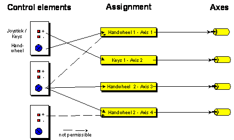

The current manual operation mode and the axis controlled by a physical manual operation element can be changed anytime. A physical manual operation element can control several axes in several NC-channels at the same time. One axis can only be controlled by one single manual operation element and can only run in one manual operation mode at the same time.
Fig.62: The manual operation and its facilities
