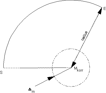

The programmed center point co-ordinates must thus lie in a circumcircle around the corrected center point of the circle. The radius of this circumcircle corresponds to the permissible center point offset Δm, which can be set using the two parameters "mittelpkt_diff" and "mittelpkt_faktor" (Fig. 2).
Settings for circle center point correction and radius compensation 1:Fig.2: Zone of permissibly programmed center points
