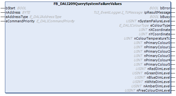

FB_DALI209QuerySystemFailureValues 4: Eingänge
  bStart            : BOOL;
  nAddress          : BYTE;
Typ
bStart
nAddress
BYTE
eAddressType
E_DALIAddressType
eCommandPriority
E_DALICommandPriority
FB_DALI209QuerySystemFailureValues 5:
FB_DALI209QuerySystemFailureValues 6: Ausgänge
  nSystemFailureLevel     : USINT;
  eColourType             : E_DALIColourType;
  nXCoordinate            : UINT;
  nYCoordinate            : UINT;
  nColourTemperatureTc    : UINT;
  nPrimaryColour0         : UINT;
  nPrimaryColour1         : UINT;
  nPrimaryColour2         : UINT;
  nPrimaryColour3         : UINT;
  nPrimaryColour4         : UINT;
  nPrimaryColour5         : UINT;
  nRedDimLevel            : USINT;
  nGreenDimLevel          : USINT;
  nBlueDimLevel           : USINT;
  nWhiteDimLevel          : USINT;
  nAmberDimLevel          : USINT;
  nFreeColourDimLevel     : USINT;
