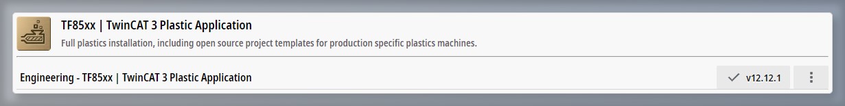

The Plastic Application can be installed under TwinCAT 4026 via the TwinCAT Package Manager. A separate workload is available for this.

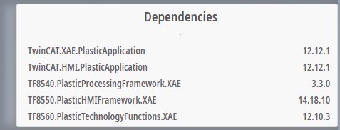

The PlasticApplication Workload installs the workloads for the three plastic products:
- TF8540 – Plastic Processing Framework
- TF8550 – Plastic HMI Framework
- TF8560 – Plastic Technology Functions
