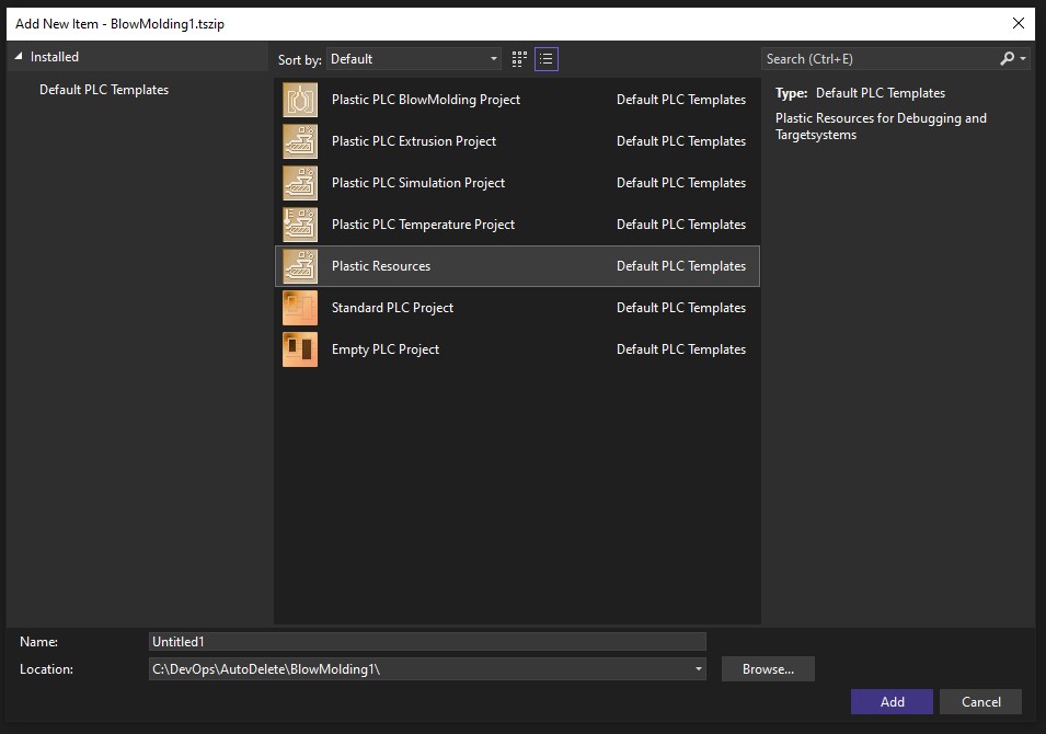

1. Right-click on the PLC node in your TwinCAT 3 project and then select Add New Item....
Setup of PLC debugging 1:
2. In the following dialog, select Plastic Resources from the list. Assign a suitable name for identification in your project.
Setup of PLC debugging 2:

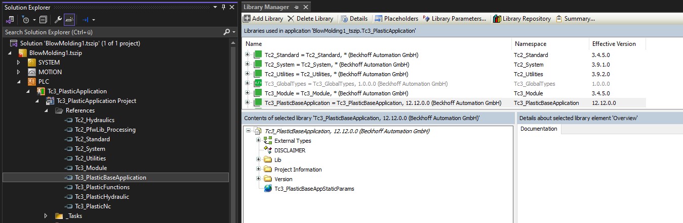

3. Navigate to the Debugging folder in the newly added PLC project.
Setup of PLC debugging 3:
You have successfully integrated the uncompiled library of the Plastic Base Application into your project. You can now use the library for a debugging process.

4. In your PLC in which the Tc3_PlasticBaseApplication is used, expand the References node and select the Tc3_PlasticBaseApplication.
Setup of PLC debugging 4:

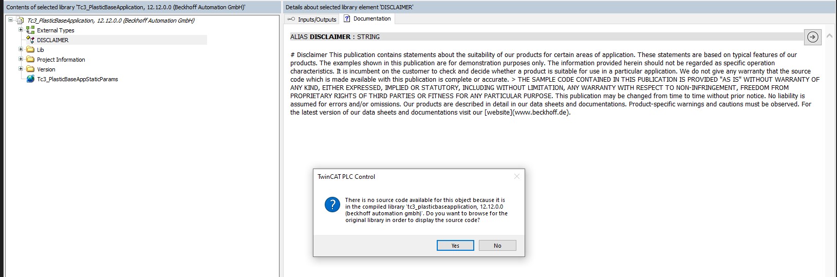

5. Then select an item from the library by double-clicking on it. DISCLAIMER is selected as an example in these instructions.
6. A dialog will appear asking you to select an uncompiled version of the Plastic Base Application. Confirm by pressing Yes.
Setup of PLC debugging 5:

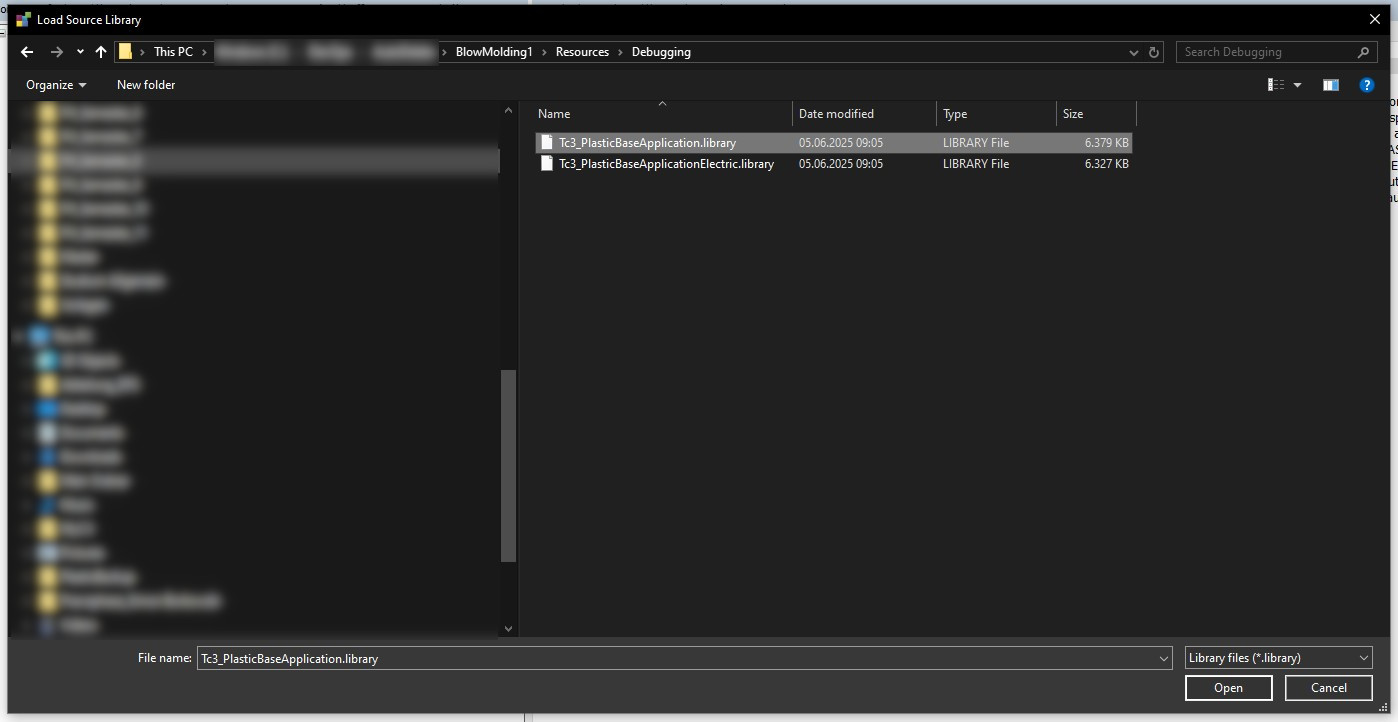

7. Navigate to the path of the previously added PLC resource and select the Tc3_PlasticBaseApplication.library file.
If you are using the Tc3_PlasticBaseApplicationElectric, you will also find the corresponding file in this folder.
Setup of PLC debugging 6:

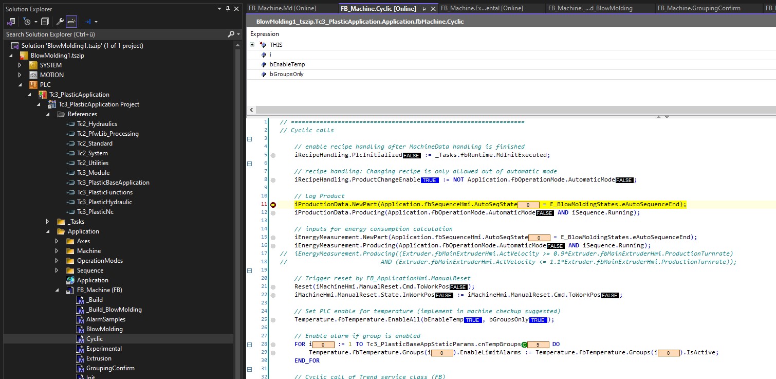

9. To start a debugging process, log into your running PLC project (1) and select a code segment in which you want to start a debugging process (here FB_Machine.Cyclic() (2) as an example).
Setup of PLC debugging 7:
10. Set a breakpoint at a suitable point (e.g. for a library function from the Tc3_PlasticBaseApplication) with F9.
Setup of PLC debugging 8:
11. Then press F11 to jump to the library function.
If there are several function calls in the code line, you may have to press F11 several times to access the desired function.
Setup of PLC debugging 9:
You now have access to the called function and have successfully performed a debugging in the Tc3_PlasticBaseApplication.
