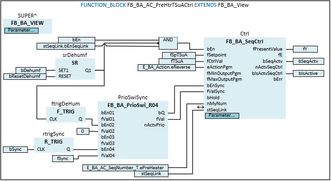

The template represents the supply air temperature control of a preheater in a ventilation system. The supply air controller Ctrl is the core of the template. It is integrated into a supply air temperature control sequence.
The sequence controller is enabled using the input variable bEn and the variable stSeqLink.bEnSeqLink of the data and command structure stSeqLink.
In dehumidification mode bDehumf, the sequence controller Ctrl is disabled and thus removed from the sequence control.
The sequence controllers are enabled for sequence control via the data and command structure stSeqLink. This is indicated by the variable bSeqActv.
FB_BA_AC_PreHtrTSuACtrl 2:
The initialization of the template takes place within the method FB_Init.

The data and command structure stSeqLink is the link between the supply air temperature sequence controller Ctrl and the supply air temperature sequence control TSeqLink of an air conditioning system.
FB_BA_AC_PreHtrTSuACtrl 7: Inputs CONSTANT
Type
Ctrl
FB_BA_SeqCtrl
The supply air temperature sequence controller Ctrl is the core of this template. It is responsible for the supply air temperature control of the preheater.
The sequence controller is also part of the supply air temperature sequence control of an air conditioning system. The data exchange within this sequence control takes place via the data and command structure stSeqLink.
The global variable E_BA_AC_SeqNumber_T.ePreHeater gives the sequence controller its sequence number within the temperature sequence control.
Variables
Type
srDehumf
SR
Setting the RS flip-flop srDehumf indicates that dehumidification mode is active within the air conditioning system. The sequence controller Ctrl is no longer enabled. The RS flip-flop srDehumf is reset via the input bResetDehumf.
ftrigDeHum
F_TRIG
A falling edge at input CLK of the function block ftrigDeHum synchronizes the sequence controller Ctrl to the value 0.
The falling edge is triggered by resetting the dehumidification mode on the RS flip-flop srDehumf.
rtrigSync
R_TRIG
On a rising edge at input CLK of the function block rtrigSync, the sequence controller Ctrl is synchronized to the value of fSync.
PrioSwiSync
FB_BA_PrioSwi_R04
The priority switch prioritizes the synchronization of the sequence controller Ctrl
