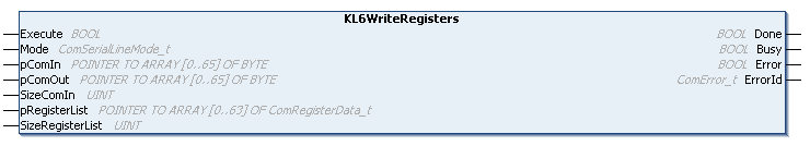

KL6WriteRegisters
The function block KL6WriteRegisters writes data to one or several registers of a serial Bus Terminal KL6xxx.
Inputs
Execute : BOOL;
Mode : ComSerialLineMode_t;
pComIn : POINTER TO BYTE;
pComOut : POINTER TO BYTE;
SizeComIn : UINT;
pRegisterList : POINTER TO ARRAY[0..63] OF ComRegisterData_t;
SizeRegisterList : UINT;
Execute | BOOL | A rising edge at the Execute input starts the read process. The register list must be initialized before the function block is triggered. This means the register numbers and register content must be entered in the list. |
Mode | The Mode input specifies unambiguously which serial hardware is being used. | |
pComIn | POINTER TO BYTE | Universal pointer to the input variable of the process data for the serial hardware (data types: KL6inData, KL6inData5b, KL6inData22b, PcComInData). The pointer is assigned with the ADR() function. |
pComOut | POINTER TO BYTE | Universal pointer to the output variable of the process data for the serial hardware (data types: KL6outData, KL6outData5b, KL6outData22b, PcComOutData). The pointer is assigned with the ADR() function. |
SizeComIn | UINT | Size of the input process image of the serial hardware being used. The size is determined and assigned with the SIZEOF() function. |
pRegisterList | POINTER TO ARRAY[0..63] OF ComRegisterData_t | Start address of a register list. The start address can be determined with ADR(register list). The register list must be initialized before the function block is triggered. This means the register numbers and register content must be entered in the list. |
SizeRegisterList | UINT | Size of the register list in bytes. The size can be determined via SIZEOF (register list). The list may have between 1 and 64 entries. |
Outputs
Done : BOOL;
Busy : BOOL;
Error : BOOL;
ErrorID : ComError_t;
Done | BOOL | The Done output becomes TRUE when the function has been carried out without error. |
Busy | BOOL | The Busy output becomes TRUE in response to rising edge at Execute, and remains TRUE for as long as the function block is performing its function. |
Error | BOOL | This output Error goes TRUE as soon as an error occurs. |
ErrorID | The ErrorID output provides an error code when an error occurs. |
