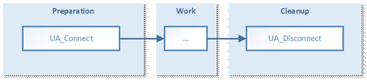

Workflow
The general workflow when using the PLCopen function blocks can be schematically represented as follows:
In the preparation phase, the communication parameters are set up and a connection to the server is established. The desired function is then executed (read, write, method calls), followed by disconnection of the communication connection.

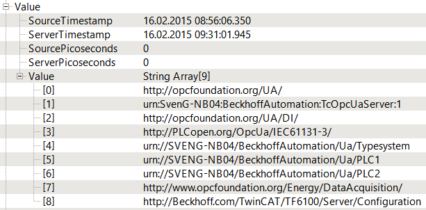

According to the OPC UA specification, the NamespaceIndex can be a dynamically generated value. Therefore, OPC UA Clients must always use the corresponding namespace URI to resolve the NamespaceIndex before a node handle is detected.
Use the function block UA_GetNamespaceIndex to obtain the NamespaceIndex for a NamespaceURI. The NamespaceURI required for this can be determined with the help of UA Expert by establishing a connection to the OPC UA server and browsing to the NamespaceArray node.
This node contains information about all namespaces registered on the OPC UA Server.
The corresponding namespace URIs are visible in the Attributes panel, for example:
The section above shows an example of a NodeID in which the namespace index is 5. According to the NamespaceArray shown in the figure, the corresponding NamespaceURI is urn://SVENG-NB04/BeckhoffAutomation/Ua/PLC1. This URI can now be used for the function block UA_GetNamespaceIndex. The OPC UA Server ensures that the URI always remains the same, even after a restart.

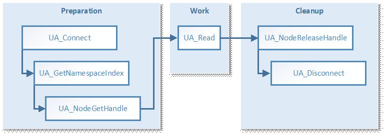

The schematic workflow of each TwinCAT OPC UA Client can be categorized into three different phases: Preparation, Work and Cleanup.
The use case described in this section can be visualized as follows:
- The function block UA_Connect requires the following information to establish a connection to a local or remote OPC UA Server (see also How to establish a connection):
- Server URL
- Session Connect Information
- The function block UA_GetNamespaceIndex requires a Connection Handle (from UA_Connect) and a NamespaceURI for resolution to a NamespaceIndex, which is later used by UA_NodeGetHandle to capture a node handle (see also How to determine communication parameters).
- The function block UA_NodeGetHandle requires a Connection Handle (from UA_Connect) and NodeID (from ST_UANodeID) to capture a node handle (see also How to determine communication parameters).
- The function block UA_Read requires a connection handle (from UA_Connect), a node handle (from UA_NodeGetHandle) and a pointer to the target variable (where the read value is to be saved). Make sure that the target variable has the correct data type (see also How to determine communication parameters).
- The function block UA_NodeReleaseHandle requires a connection handle (from UA_Connect) and a node handle (from UA_NodeGetHandle).

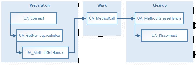

Calling methods
The following section describes how you use the function block TcX_PLCopen_OpcUa to call methods on a local or remote OPC UA server. The following function blocks are required to connect to an OPC UA server, call UA methods, and subsequently interrupt the session: UA_Connect, UA_GetNamespaceIndex, UA_MethodGetHandle, UA_MethodCall, UA_MethodReleaseHandle, UA_Disconnect.
- The function block UA_Connect requires the following information in order to be able to establish a connection to a local or remote OPC UA server (see also How to establish a connection):
- Server URL
- The function block UA_MethodGetHandle requires a connection handle (from UA_Connect), an ObjectNodeID and a MethodNodeID to capture a method handle (see also How to determine communication parameters).
- The function block UA_MethodCall requires a connection handle (from UA_Connect), a method handle (from UA_MethodGetHandle) and information about the input and output arguments of the method that is to be called. Information about the input arguments is represented by the input parameters pInputArgInfo and pInputArgData of UA_MethodCall. Information about the output parameters is represented by the pOutputArgInfo and pOutputArgData input parameters of UA_MethodCall. The input parameter pOutputArgInfoAndData then represents a pointer to a structure containing the results of the method call, including all output parameters. The following code snippet calculates and creates the pInputArgInfo and pInputArgData parameters in the M_Init method.
- The function block UA_NodeReleaseHandle requires a connection handle (from UA_Connect) and a method handle (from UA_MethodGetHandle).
