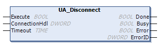

This function block closes an OPC UA Remote connection to another OPC UA Server. The connection is specified via its connection handle.
UA_Disconnect 2:
Disconnect all connections
If the UA-Disconnect method is called and a connection handle of 0 is passed, the OPC UA client disconnects all existing connections. This also applies to connections established via an OPC UA I/O client configuration.
UA_Disconnect 3: Inputs
    Execute           : BOOL;
    ConnectionHdl     : DWORD;
    Timeout           : TIME := DEFAULT_ADS_TIMEOUT;
Type
Execute
The command is triggered by a rising edge at this input.
ConnectionHdl
DWORD
Connection handle previously output by the function block UA_Connect.
Timeout
TIME
Time until the function is aborted. DEFAULT_ADS_TIMEOUT is a global constant, set to 5 seconds.
UA_Disconnect 4: Outputs
    Done        : BOOL;
    Busy        : BOOL;
    Error       : BOOL;
    ErrorID     : DWORD;
Type
Done
Switches to TRUE if the function block was executed successfully.
Busy
TRUE until the function block has executed a command, at the most for the duration of the "Timeout" at the input. The inputs accept no new command as long as Busy = TRUE. It is not the connection time that is monitored but the reception time.
Error
Switches to TRUE if an error occurs while executing a command. The command-specific error code is contained in nErrID.
ErrorID
DWORD
Contains the command-specific error code of the most recently executed command.
