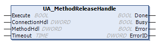

UA_MethodReleaseHandle
UA_MethodReleaseHandle 1:
This function block releases the specified method handle.
UA_MethodReleaseHandle 2: Inputs
    Execute           : BOOL;
    ConnectionHdl     : DWORD;
    MethodHdl         : DWORD;
    Timeout           : TIME := DEFAULT_ADS_TIMEOUT;
Type
Execute
The command is triggered by a rising edge at this input.
ConnectionHdl
DWORD
Connection handle previously output by the function block UA_Connect.
MethodHdl
DWORD
Method handle previously output by the function block UA_MethodGetHandle.
Timeout
TIME
Time until the function is aborted. DEFAULT_ADS_TIMEOUT is a global constant, set to 5 seconds.
UA_MethodReleaseHandle 3: Outputs
    Done     : BOOL;
    Busy     : BOOL;
    Error    : BOOL;
    ErrorID  : UDINT;
Type
Done
Switches to TRUE if the function block was executed successfully.
Busy
TRUE until the function block has executed a command, at the most for the duration of the "Timeout" at the input. The inputs accept no new command as long as Busy = TRUE. It is not the connection time that is monitored but the reception time.
Error
Switches to TRUE if an error occurs while executing a command. The command-specific error code is contained in nErrID.
ErrorID
UDINT
Contains the command-specific ADS error code of the most recently executed command.
