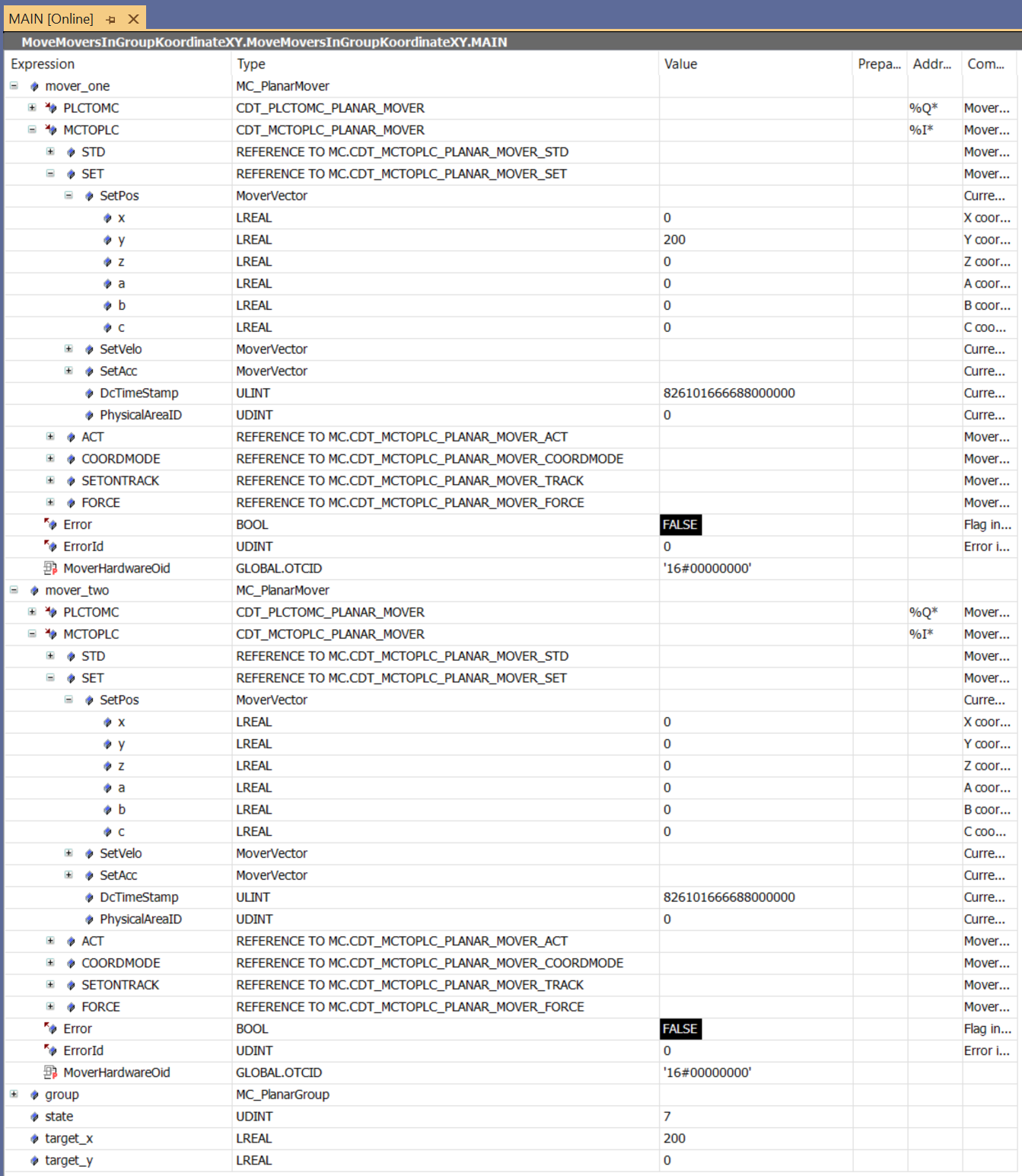

After logging into the PLC and starting, you will see that the movers are both in the target positions at the end of the state machine (state=7). Mover 1 has moved to x = 0 and y = 240. Mover 2 drove to the starting point and was temporarily blocked by Mover 1 during the journey.
Since the dynamic limits of the movers are quite high by default, the change of positions after logging in may be difficult to follow with the naked eye. For the dynamic limits, see Planar mover.
Example "Create Planar movers with group and move based on coordinates (MoveX, MoveY)" 9:
