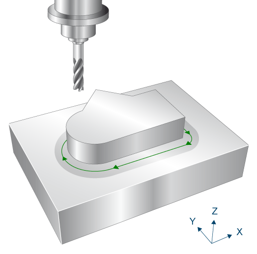

This cycle is for path milling.
The path milling cycle can remove a 2D contour path defined in advance. The path need not be closed (identical start and end). For machining, tool radius compensation with optional finishing allowance at the edge and base can also be selected. In addition, various approach and withdrawal movements can be added to the milling process.
The geometrical description of the contour in the X and Y axes is provided by a Contour definition.
