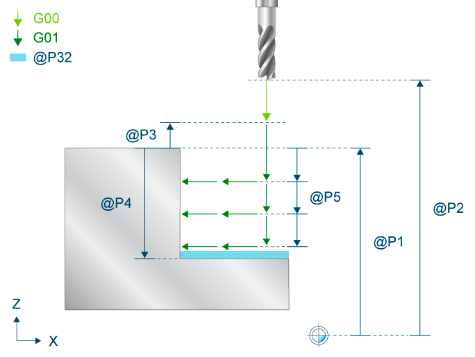

Parameterisation
Required input parameters:
Input parameters
@P1
Reference plane (absolute)
@P2
Retraction plane (absolute)
@P3
Safety clearance in Z (relative to reference plane/machining height)
@P4
Depth (relative to reference plane)
@P5
Maximum infeed in Z
@P50
Identification number of the path contour

Most of the parameter functions which mainly refer to the Z axis are displayed in the graphic below:
It is recommended to use the Syntax check to verify whether the input parameters are correctly assigned.
