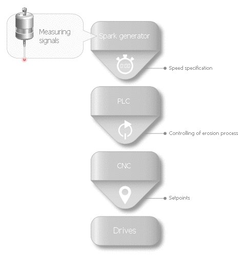

The figure below shows an overview of the individual components involved in motion control in the EDM process:
Description 1:
Overview of components involved in the EDM process
The spark generator is the component that provides the specified velocities to control the gap based on the current values measured on the workpiece. The PLC uses this specified setting depending on the current erosion mode to transfer the necessary data to the CNC to guide the electrode motion. This generates the setpoints for the drives while maintaining maximum dynamics for optimum motion control to achieve optimum machining results.

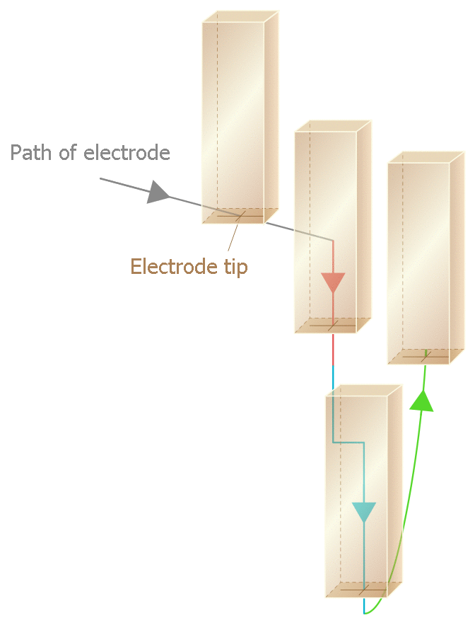

When positioning, the electrode is moved to a position above the starting point for machining.
It can then be decided how the workpiece is to be machined. A distinction is made between erosion on the path, erosion with orbiting or erosion on the path followed by erosion with orbiting.
The machining processes differ in the way the electrode is guided. In erosion on the path, the electrode moves forwards and backwards along a programmed path.
In erosion with orbiting, the motion of the electrode is produced from two asynchronous or synchronised 2D geometries. The escape motion away from the current electrode point is calculated based on an escape strategy.
After EDM machining, the electrode can be retracted from the workpiece.

Programming the TCP = motion of the electrode on the path

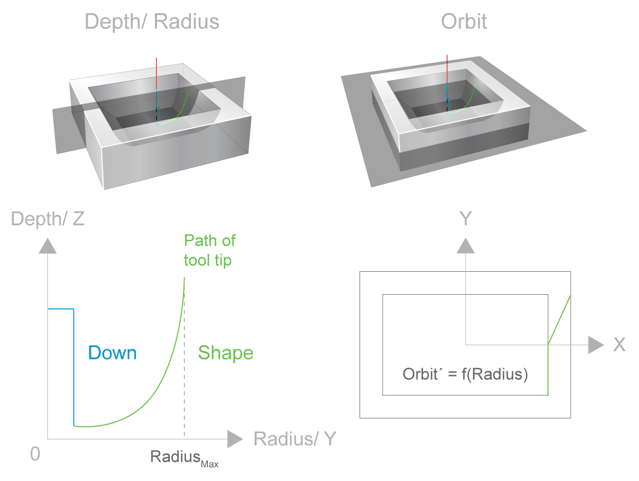

Guiding the electrode when orbiting is divided into 2 processes:
  1. Down to the RZ plane
  2. Orbit motion in the X-Y plane
These processes can be completely asynchronous or partially synchronised depending on the type of EDM used.
Description 4:
Division into sinking and orbiting motions

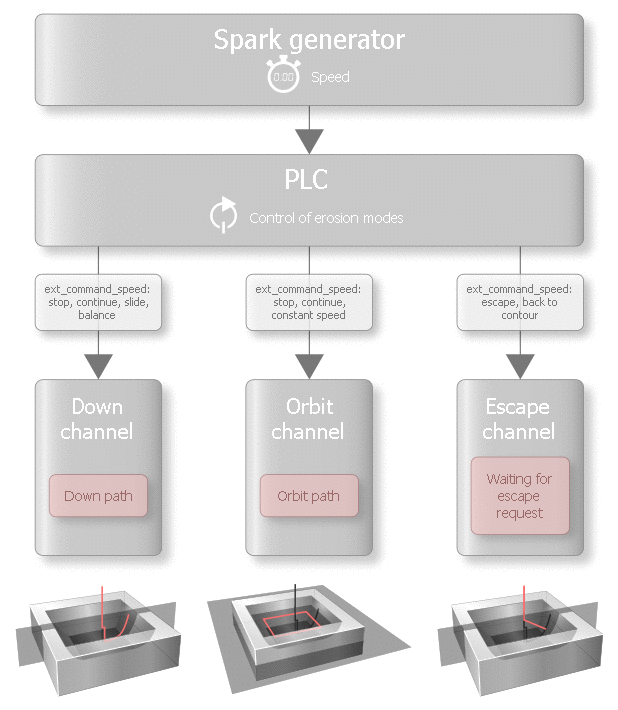

CNC architecture for die sinking
In order to fulfil the requirements of the EDM process, three NC channels are used in the CNC control system and together they control the axes of the EDM machine.
The three channels are shown in the figure below: In this document, they are referred to as follows:
  1. Down channel
  2. Orbit channel
  3. Escape channel
Each channel is always assigned its own NC program and has its own status and position display. The down channel is the main channel controlling the orbit and escape channels and establishes a link between the channels.
Description 5:
The three die-sinking channels

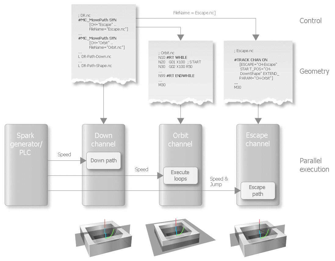

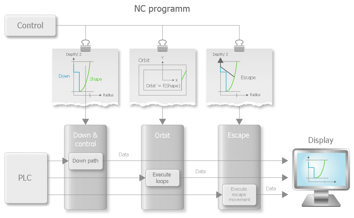

The down channel assumes the task of the main channel and commands and starts the other two channels. Among other things, the geometry of positioning and erosion on the path are executed in their own NC program. During the orbiting phase, only a two-dimensional contour may be programmed (see figure above).
The orbit channel simultaneously performs the motion on its programmed geometry in an endless loop. The X and Y coordinates returned to the down channel depend on the current position in the orbit channel and on the radius transferred from the down channel. The resulting three-dimensional motion is generated by superimposing both of the two-dimensional motions.
The escape channel is programmed in the same coordinate system as the down channel. This channel controls the escape motion of the electrode. There are different strategies to calculate an escape path during program runtime based on the current position in the down channel. The escape channel moves along this escape path. This allows the gap size to be set irrespective of program progress in the down channel. The velocity of the escape channel, just like the velocity in the down channel, is a variable that is controlled by the process and is specified by a spark generator. In addition, the escape channel is used to initiate the flushing process by means of a jump movement to enable an optimised flushing process, fast escape and a quick restart on the escape path.
Description 6:
NC programs of the three channels in the die-sinking process
The approach using separate channels allows progress in the RZ plane to be independent of the progress of the orbit motion and enables constant adjustment of the gap size using the escape channel.
