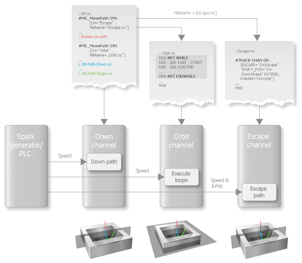

Down channel
A down channel has the function of a master channel. The channel couplings that it triggers implicitly initiate the different phases of the erosion process.
The channel couplings must be executed in a fixed sequence. The sequence for an EDM program is as follows:
  1. Start the main NC program in the down channel.
  2. Positioning
  3. Activate the escape channel.
  4. Start the erosion process on a path (optional).
  5. Activate the orbit channel and start the erosion process for orbiting. (optional)
  6. Deactivate the auxiliary channels.
  7. Electrode escape and end of machining
Notice
When coupling/decoupling, the channels must be at standstill.
If this is not the case, error ID 51021 is output.
Down channel 1:
Machining phases during die sinking
