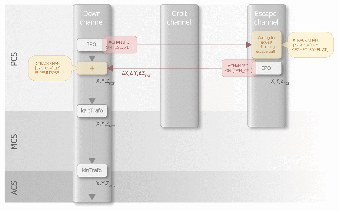

Erosion on the path is the first phase when the erosion process is active. Since the escape channel executes the escape motions of the electrode, it must be activated before the geometry for erosion on the path (GEP).
Activating the escape channel implicitly means the start of the phase for erosion on the path. The orbit channel remains inactive throughout this entire phase. The escape channel can be executed by channel coupling with superimposition of the coordinates of all axes, erosion and flushing motions.
Erosion on the path 1:
Channel view for erosion on the path
