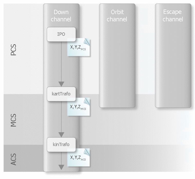

Positioning
Before the erosion process starts, the electrode must be positioned in the down channel above the workpiece. In this phase, the orbit and escape channels are inactive and the down channel acts as a standard NC channel. This means that all axes are physically moveable through the down channel by using coordinate systems and kinematic transformations.
Positioning 1:
Overview of down channel during positioning
