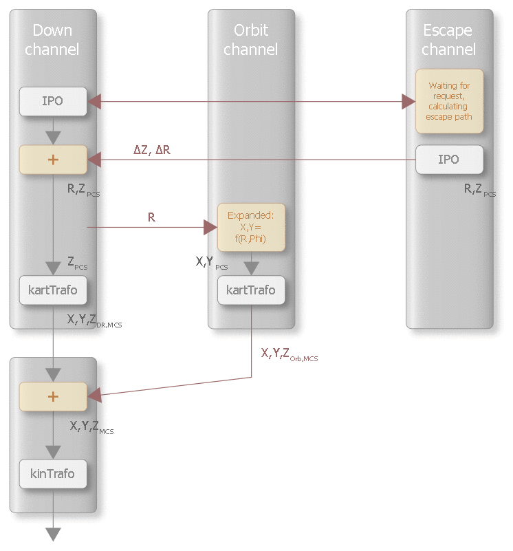

The escape motion of the electrode is executed in the escape channel and superimposed on the motion of the down channel.
The figure below shows the relationship between channel interfaces and the superimpositions ∆Z and ∆R viewed from the down channel:
Escape channel 1:
Superimpositions ∆Z and ∆R viewed from the escape channel
