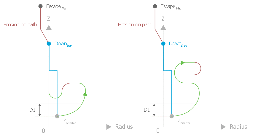

Angle bisector strategy 1:
Possible paths of the angle bisector strategy

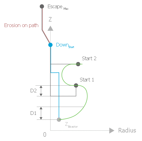

As a special case, this strategy results in a horizontal and possibly also a perpendicular motion in the down channel. The escape motion is either identical to the flat motion (‘Start 2’ in the figure below) or perpendicularly downwards. (‘Start 1’) - depending on which direction is closest to the escape motion direction of the previous contour element of the geometry in the down channel.
Angle bisector strategy 2:
Special case for angle bisector strategy

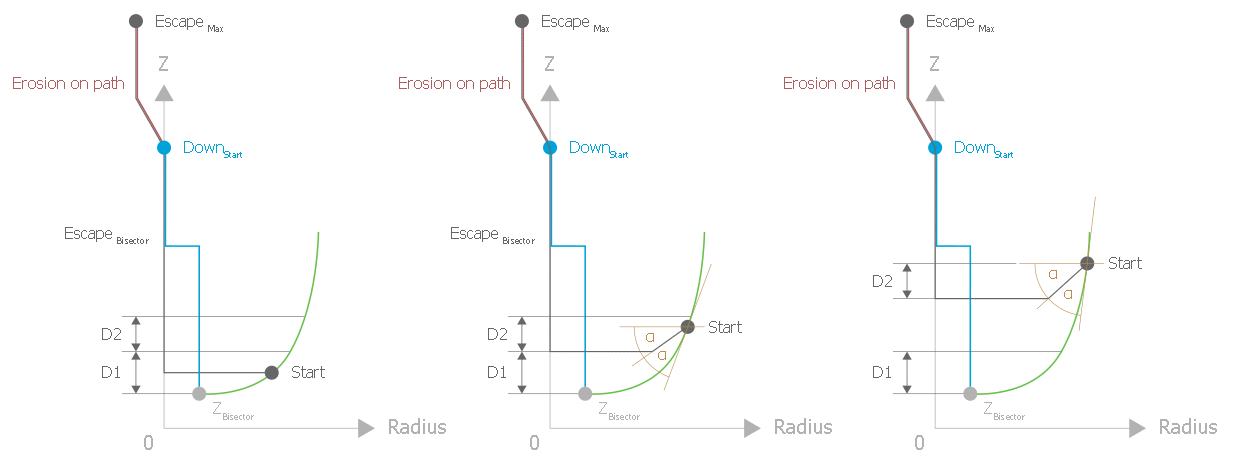

In the angle bisector escape strategy, a check is made during program runtime to ensure that the angles 0° and 180° between the tangent and the horizontal are not exceeded. This check takes place above height ZBisector + D1. If the angle is exceeded, this would result in a jump to geometry planning and therefore also a position jump with an active escape motion. Error ID 51031 is then output. The geometries shown in the figure below are therefore not possible due to the section marked by a solid red line.
Angle bisector strategy 3:
Boundary geometries with angle bisector strategy
