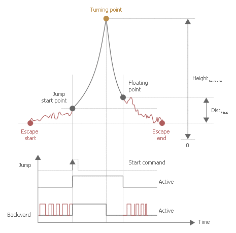

The figure below shows an example of a command sequence for a flushing process:
- The bottom section shows a schematic diagram of the signals for backward motion active, flush active and the flush start command signal on the HLI of the escape channel over time.
- The upper section shows an example of a geometry matching the signals. Only the Z axis moves in this case. The example shows a command during an active escape motion and with premature abort of the flushing process by the floating point.
