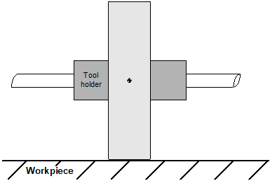

It is assumed that the entire width of the lateral surface of the grinding disc is in contact.
