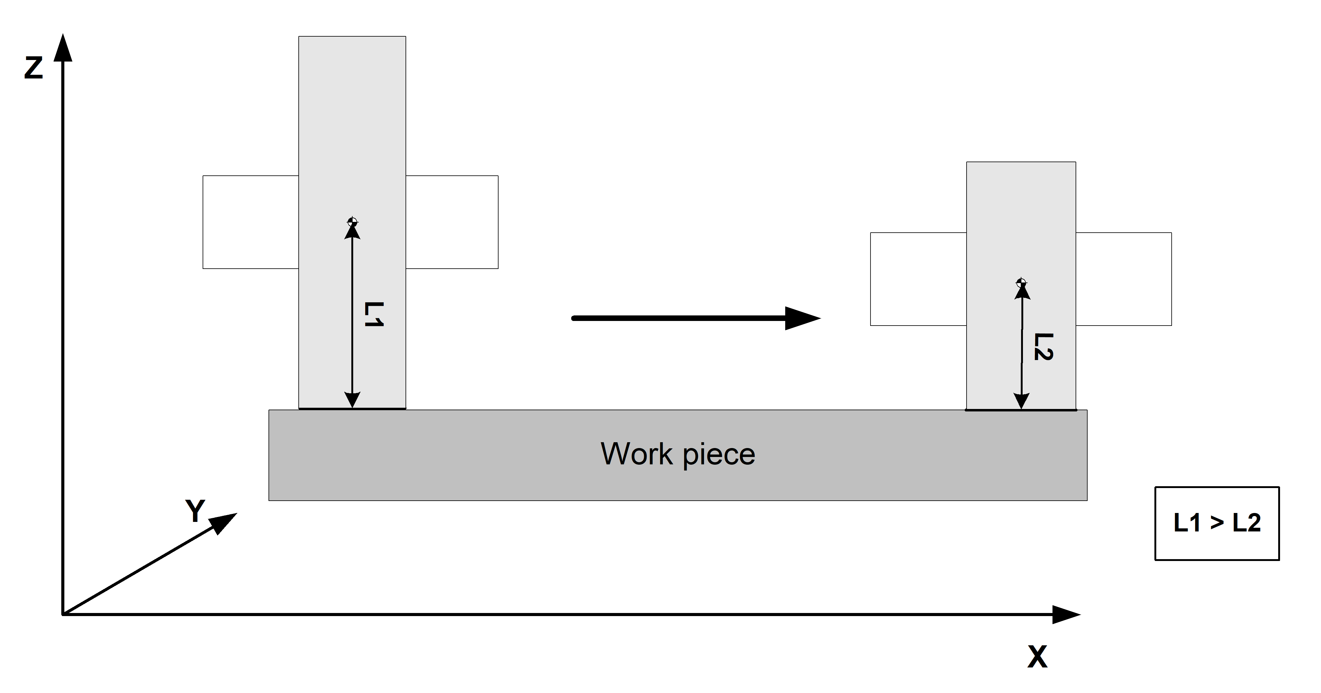

When the tool length is compensated (length compensation), wear is compensated in the direction of the 3rd main axis. This can take place both continuously and discretely. This procedure is used in particular for processing surfaces (surface grinding).
Wear compensation of tool length 1:

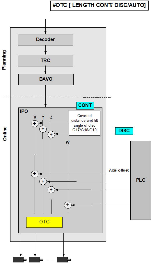

Distributing continuous wear on 2 main axes depends on the inclination of the grinding disc as described in section Inclined grinding disc.
The LENGTH operation mode is shown in the figure below:
Wear compensation of tool length 2:
Description of LENGTH function
