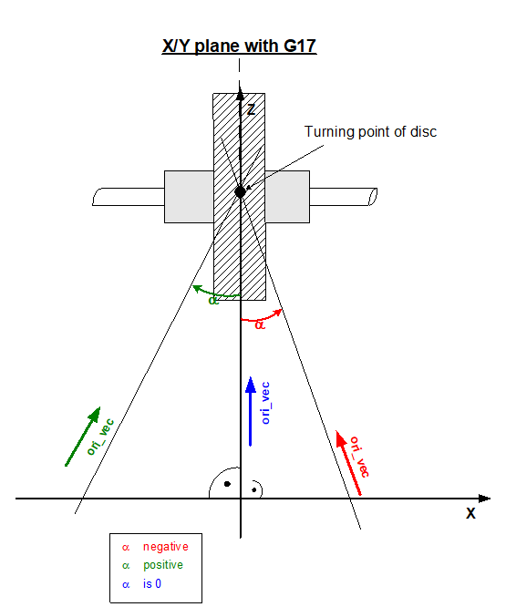

The incline of the grinding disc is only entered in the tool list (P-TOOL-00138) to grind inclined surfaces. Here the complete lateral surface of the grinding disc is also in contact.
The figure below shows the orientation of the tilt angle using the example of the G17 plane:
Inclined grinding disc 1:
Tool orientation is determined by the disc tilt angle. This tool orientation can then be used to apply the resulting wear proportionately to the main axes.
In the figure above, wear is included in the calculation of the X and Z axes.
